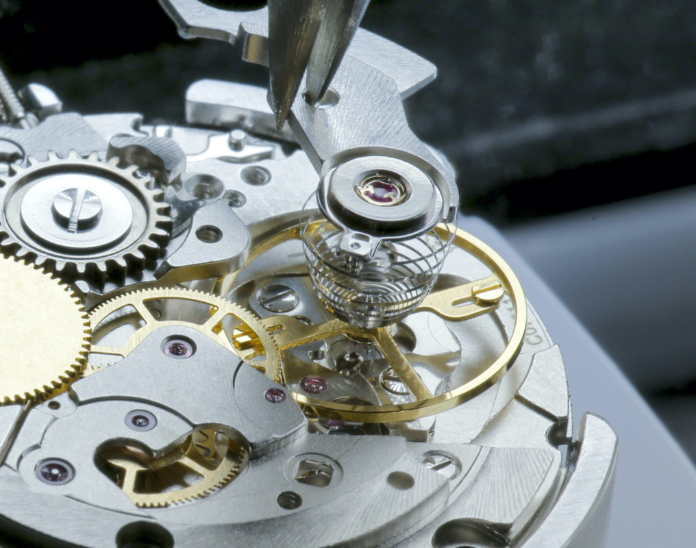

The differences with the ETA 2824-2 go even deeper; it’s not even made from the same material. Exactly which materials have been used in the different Powermatic calibres, Swatch Group doesn’t tell, but our information tells us that the steel alloy is a bit different from usual movements, the so-called ARCAP alloy, which is anti-magnetic. (For the real metal-heads among us: it is made up of a combination of nickel, copper, cobalt, tin, lead and zinc.) In some cases, ETA even adds plastic materials to the movement.

The “System 51” watches are not designed to be user serviced, as they are regulated by a machine according to laser measurement. ... So the Powermatic 80 is like a step between a “System 51” not serviceable movement and the ETA 2824-2 which is found on watches a price jump above those with the Powermatic 80.26 Απρ 2019

HOW TO TELL THE DIFFERENCE?
An easy way to distinguish the difference between the base calibers in Tissot Powermatic 80 models is to look at the features and/or text on the rotor:
Powermatic 80.111 (ETA C07.111)
Features: Date at 3:00 or 6:00
Rotor: High-Tech Escapement / Twenty-Three 23 Jewels / Swiss Made
Powermatic 80.111 COSC (ETA C07.111 COSC grade)
Note: The dial or caseback will have Certified Chronometer text, but not the rotor.
Powermatic 80.121 (ETA C07.141)
Features: Day at 3:00 or wide date at 12:00, date at 3:00 or wide date at 6:00
Rotor (black): High-Tech Escapement / Twenty-Three 23 Jewels / Swiss Made
Note: Tissot shows the caliber 80.121 as being in the Couturier (day at 12 and date at 6) as well as the PRC 200 (day and date at 3), but the calendar layout is different enough to call for different caliber numbers and the images show an ETA C07.141 base movement in the Courturier and an ETA C07.111 base in the PRC 200.
PLASTIC PARTS:
There is confusion about whether or not the Powermatic 80 movement uses plastic parts (similar to the Sistem51). First, it’s important to acknowledge that there is more than one Powermatic 80 caliber. For example, The Tissot Luxury line has the Powermatic 80.111 with 23 jewels and uses plastic parts. The COSC rated Powermatic 80.811 found in the Tissot Ballade does not.
